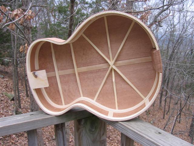

Well, it has been fun getting ready for the boat to show up. Michael got me the abalone Dave originally donated. I got it inlaid in the Sitka top. Paul got the linings he furnished into the rimset and glued up and braced the back. He ships it today for Arkansas.
The top is nigh ready for carving, lacking the transverse brace which I'll place after carefully reviewing the actual measurements of the rimset boat. I must say I was impressed with Paul's work, really nice Paul.
So, that's about it. I guess Brock has everthing he needs to bind and purfle this baby. The guitar case evidently won't have a chance to materialize before the ship to Ohio. So it'll probably ship back in the box Paul ships in. Won't be long and this thing will head West to John. Pretty cool.

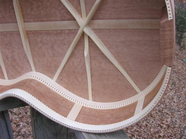

Brock, 1) I didn't close it, that's BD's job. I took pics of it which are on the week #3.

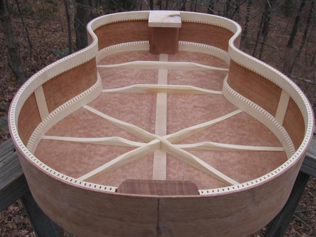

Paul Woolson finished up the back, sides, and linings, plus neck block with extension. Here is the result, he asked me to take a picture.

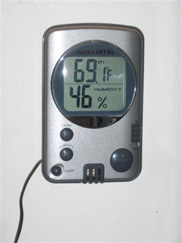

Great job Paul and Lance! Shop temp and RH posted above, tomorrow the top joins the party! Get ready Brock, here it comes, case or not. That was one sturdy box, Paul. Bruce Dickey38784.6642939815

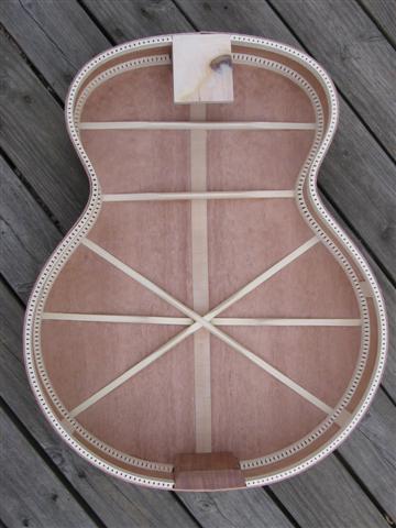

They are very very rigid. As seen in this photo from Week Three, the mold is only used during end block and linings installation and no longer needed to apply top and back plates. Great design.

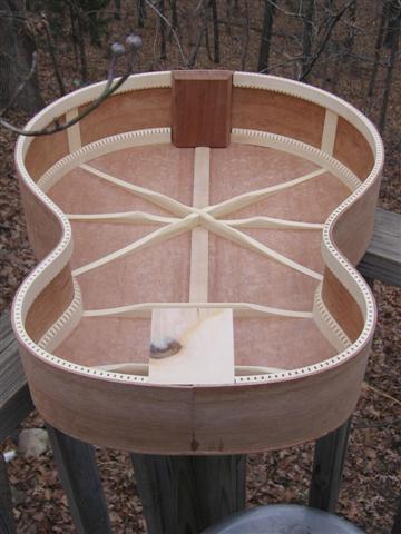

That is fixed and ready for the top. Good Old Hide Glue and some Klemmsias. I hear that boat calling my name from here. Aaron's and this one, get topped today, yippee!

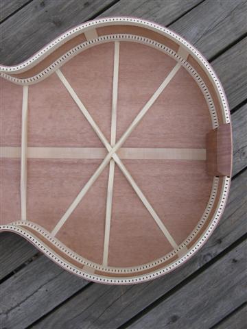

That's a gap that I let pass, assuming that the mortise would cut it out anyway. BD found that the sides slightly hung up on each other which is why it didn't close in the first place. He made a saw kerf and got 'er closed up just fine.
Nothing like having your mistakes posed on the internet.
